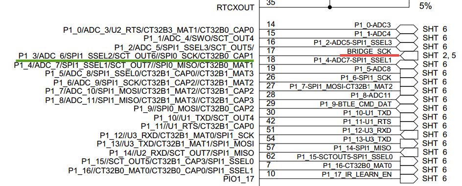

jeremyzhou
Hi Ratheesh T,
The BRIDGE_SCK pin of the J3 is assigned to the P1_3 (Fig 1). However the SPI0_SCK is assigned to the P0_11 in the periph_spi_sm_int demo.
So I think it's the root cause of your issue.
                                                                                Fig 1
Ping
