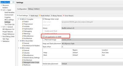

I have an LPC54102 dual core project the I have been developing for quite some time now.
The M4 is executing its code from FLASH but the M0 slave has been copying its code to SRAM and executing from there. The M0 code base is getting large and I am running out of RAM. I would like to re-configure to executing both M4 and M0 processors from FLASH.
I see that in MCUxpresso linker Multi-core options I can change this. (In the attached image, I changed the "Master memory region" to "Flash"). However, if I change this option, I then get a compiler error:

I guess my question was not clear. I will try again using the lpcxpresso54102_hello_world_cm0plus & lpcxpresso54102_hello_world_cm4 multi-core example.
Below you can see that the cm4 code is stored in FLASH, but the cm0plus code is loaded into RAM.
According to AN11609 it is possible, on the LPC5410x, to run both cm3 & cm0plus code from flash. However, I can not find information on how to configure this in MCUXpresso. That is my question, how can I re-configure this project so that both cores are executing their code from RAM?

Hi DanielR
There is configuration "Link configuration to RAM", please check in master code and see if this is what you are looking for.
