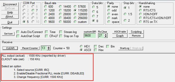

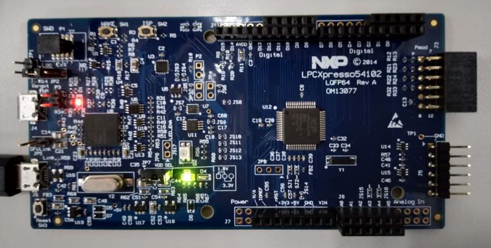

I've ran the periph_pllfract demo with my my board (LPCXpresso54102 Rev A OM13077).
As a result, the demo works well (Fig 2) without encountering the same issue as you mentioned above, and I've attached the screenshot of testing result.
So I'd like to suggest that you'd better to check the hardware of your board again.
Fig 1
Fig 2
