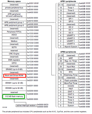

I have take a look to the iap demo project but it flashs only the sector 1 of the LPC Flash memory.
I think it works because the iap demo project, due to his little memory occupation, is stored in sector 0 and it occupies only this sector . The iap demo flashs only sector 1!! It doesn't try to flash sector 0 itself..
In my application the code occupies more than one sector and I want to flash the entire Flash memory region (sector 0 to sector 15). I noted that when I try to Flash the sectors were my code is stored the application crashes.. Otherwise if try to flash a sector were my code isn't stored the Flash algoritm seems to works.
My opinion is that it's not possible to Flash the sectors were the iap functions are running because this operation will be erase the code and the iap functions itself and this causes the crashes.
I think it's needed to run the iap and spi functions on RAM memory or on one Flash sector will be not flashed.

3,813 Views
ZhangJennie
Yes, you can copy your appliaction code to RAM and run it from RAM.
IAP code is in Boot ROM but not 512KB on chip Flash memory. So it will not be erased.
