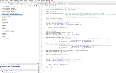

Harry_Zhang
Hi @rhsalced
Your DMA descriptors are configured as a ring (cyclic):
dmaSPISTxDesc[0].next = DMA_ADDR(&dmaSPISTxDesc[1]);
dmaSPISTxDesc[1].next = DMA_ADDR(&dmaSPISTxDesc[0]);
That implies continuous DMA transfer, not single-shot.
I think you can refer to the sdk demo.
Or i think you can  Simplify to One-Shot DMA and Restart It
Disable the next field (no chaining):
dmaSPISTxDesc[0].next = 0;
dmaSPISRxDesc[0].next = 0;
Set CFGVALID on every start:
Move xfercfg setup into the main loop. For example:
void start_spi_dma_once(void)
//set up tx and rx
Harry
