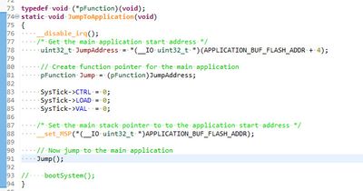

This is function jump to App.
z2609768789476_1470e7ac44399085c74f940648e60380.jpgz2609768789476_1470e7ac44399085c74f940648e60380.jpg
Application can run function peripheral init and some function other but it not run at line 193

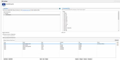

This is config memory in MCUXpresso IDE.
z2609767682294_d66d40ac6aa954163bd2f5cf366b1cb8.jpgz2609767682294_d66d40ac6aa954163bd2f5cf366b1cb8.jpg
Why is application not run. What is the wrong in my code or config.

From the bootloader side, I think that you could check the following   recommendations from this ARM post:  How to write a bootloader. Prior to performing jump to the application there are additional steps like clearing  pending NVIC interrupts, load  the vector address of the user application, make sure the CPU is in privileged mode etc.

2. I tried change jump to application function with your suggest but it doesn't change with my problem.
3. If load application image FreeRTOS by j-link then bootloader can jump to application and it run good, no hard fault or other exceptions. I checked memory  at 0x40000 when load image by j-link and RS485 but don't have any different. Application only run when load by j-link.
What's so special when load application by j-link or config flash memory ?
