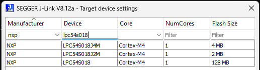

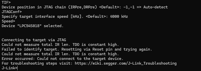

Hi All,
     Currently I have a MCU-LINK PRO, and I am using it as a J-Link probe. I am trying to connect my custom board (LPC54S018JET180E) to the MCU-Link Pro with J-Link Commander to test the hardware setup of my custom board. My ultimate goal is to be able upload a "Hello World" firmware to my custom board by the use of MCU-Link Pro.

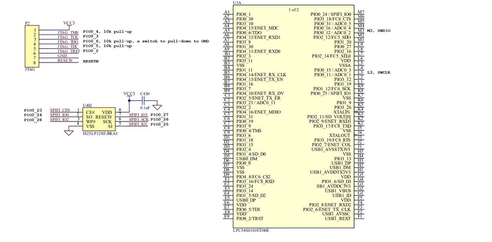

     My current set up is [TMS, TDI, TDO, RESETN](PIO0_4,5,6, PIO1_24) to MCU-LINK PRO (J7_2,6,8,10) with a 10K pull up resistors. And [TCK](PIO0_3) to MCU-LINK PRO (J7_2) with a 10k pull down resistor.
     I tried to use J-Link Commander to verify the hardware setup, but I got an error message as below:
     Does the device selection affects the connection? Currently I selected "LPC54S018".
     Please share insight and advice on this matter.

Hello @mtsang
LPC540xx supports JTAG boundary scan but does not support JTAG debugging. Please use SWD debugging instead.
Thank you.

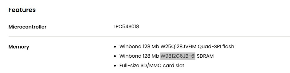

     My intention is to upload a simple firmware like "Hello World" to my custom board's External SPI Flash. Also the custom board boot up by reading the external SPI Flash.

Hello @mtsang
Please use SWD interface. Only two pins are needed.
For hardware design, you may refer to the schematic of LPC54s018-evk or the thread below:
https://community.nxp.com/t5/LPCXpresso-IDE-FAQs/Design-Considerations-for-Debug/m-p/469565

mtsang
Hi Alice,
     I am able to get the below message after I use the SWD connection. Does that mean I am able to connect to the LPC54S018JET180E? I also connected the "ResetN" from my custom board to the MCU-Link Pro's J7_10
My next question will be how to setup the "Hello_World_qspi_xip" demo. I imported and built the example project but I get the below message instead. Is there any setting that I missed?

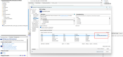

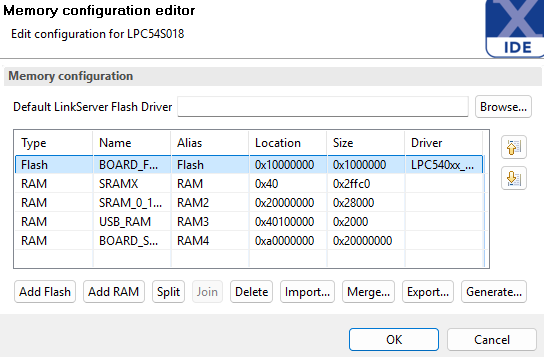

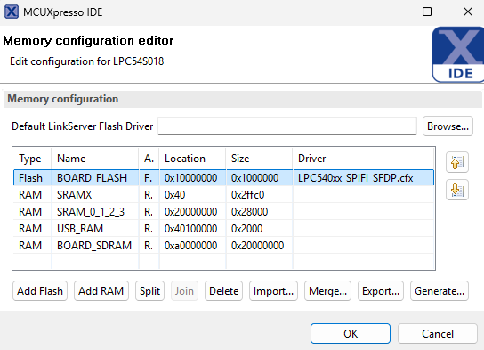

Hello @mtsang
Please confirm that you have selected the correct flash driver as follows:
If still has issue, please create a new MCUXpresso IDE workspace, and import new example.
Then take  a video show all your debug steps. I help you check.
Alice

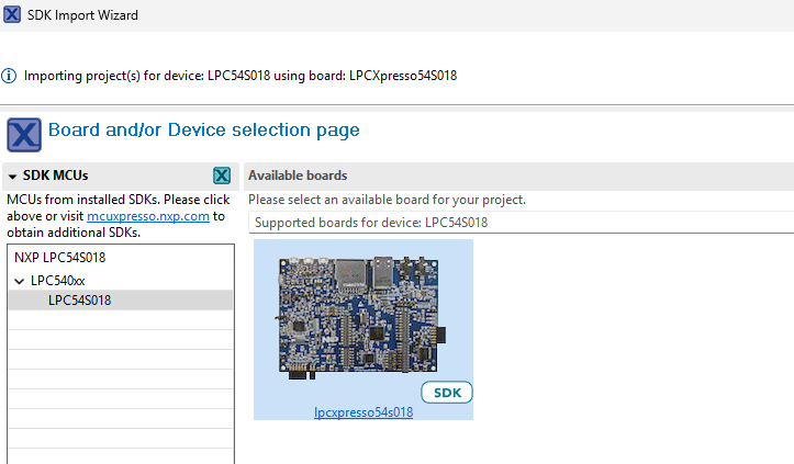

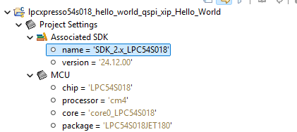

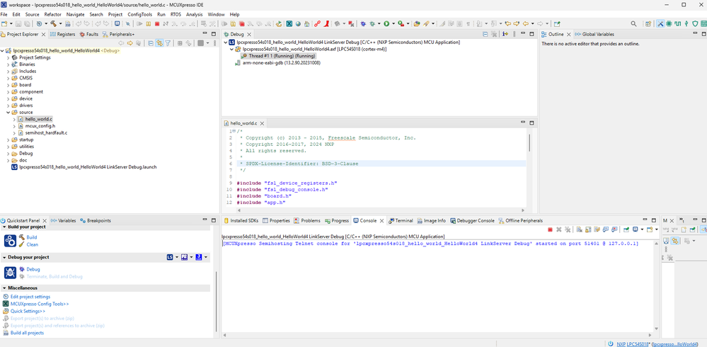

mtsang
Hi Alice,
     Thank you for your response!
     I followed the below table during the programming. I used pull-up resistors for PIO0_4,5, and a switch to pull down PIO0_6 during the programming.
     I am using 'IS25LP128F-JBLA3' and connected it to PIO0_[23-28] on my custom board.
     I created an new workplace, but I am still getting the same error.
Here is my correct flash driver setting:
Here is the error message:

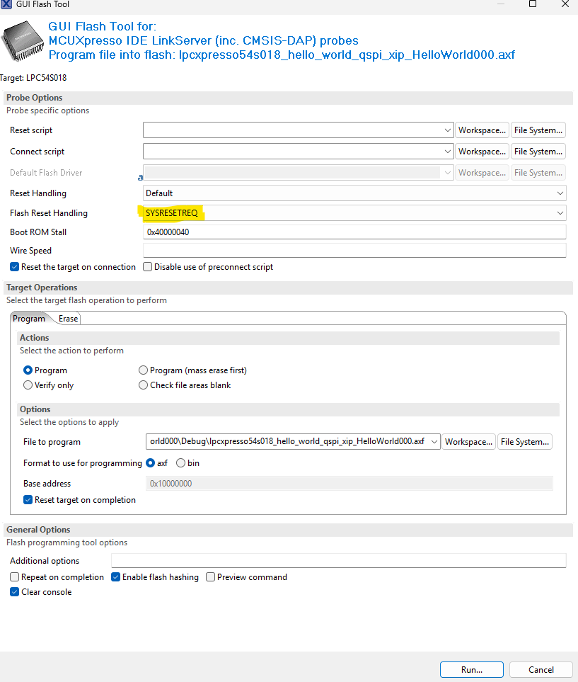

     I used the following setting in the "GUI Flash Tool", and I got the below error message. I didn't happen to lock the MCU, do I?
Executing flash operation 'Program' (Program file into flash: lpcxpresso54s018_hello_world_qspi_xip_HelloWorld000.axf) - Mon Jun 09 16:36:32 PDT 2025
Checking MCU info...
Scanning for targets...
Executing flash action...

Sending SYSRESETREQ to run flash driver
rst - Boot ROM stall address was not accessed (but we entered debug on VectorCatch anyway)
There was a problem after we succesfully downloaded flash driver code to the target, so we are going to compare the flash driver code with the memory where it was loaded.
Note that, after driver initialization, some difference is normal in 'generic' drivers.

AFTER driver startup timeout (302 5ms retries)
Driver Addresses
Start: 00000000
Entry: 0000009D
End: 0000128C
Stack: 00002290
Mailbox:0000A290
Driver Register State
R0: 00000000
R1: 200273F8
R2: 030095A1
R3: 00000000
R4: 40000000
R5: 00000000
R6: 00000000
R7: 00000000
R8: 00000000
R9: 00000000
R10: 00000000
R11: 00000000
R12: 00000000
SP: 00002288
LR: 0300BBA5
PC: 0300BDF2
xPSR: 21000000
MSP: 00002288
PSP: 00002290
CFBP: 00000001 (CONTROL=0x0, FAULTMASK=0x0, BASEPRI=0x0, PRIMASK=0x1)
Flash Driver V.2 startup failed - rc Ef(34): Timed-out initializing flash.
chip initialization failed - Ef(34): Timed-out initializing flash.
failed to initialize flash driver LPC540xx_SPIFI_SFDP.cfx
( 65) Chip Setup Complete
(100) Target Operation Failed
Unable to perform operation!
Command failed with exit code 1

mtsang
Hi Alice,
     I imported the "hello_world" demo and I didnt make any change at all. And here is the result I got:
mtsang_0-1749600017737.pngmtsang_0-1749600017737.pngScreenshot 2025-06-10 170249.pngScreenshot 2025-06-10 170249.png
     Does it count as a successfully uploading?

mtsang
Hi Alice,
     I see that from the LPC54S018 SDK, the dev board has both external QSPI(W25Q128JVFIM) and external SDRAM(W9812G6JB-6I).
     Since my custom board only has an external external SPI NOR Flash, do I need to adjust the memory in the "Project Setting"? Is there a SDK/example that is for LPC54S018JET180E and an external flash(IS25LP128F-JBLA3) only?
SDK, Example I am using:
6/13/2025
5,653件の閲覧回数
Hello @mtsang
Please create a new project based on LPC54s018, not SDK demo. Then debug. It only uses Internal RAM.

6,016件の閲覧回数
mtsang
Hi Alice,
     Attached is the schematic of my custom daughter board.
