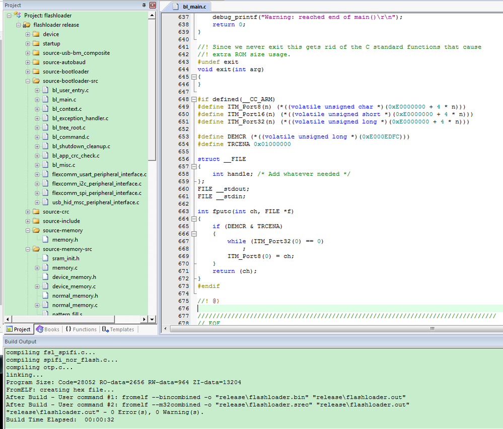

belmontbob59
Do you have some sample project to flash LPC54018JxM’s internal flash?
I’ve downloaded full 54S018M::SDK 2.5.0 but could not find any example.
While browsing SDK builder’s standalone examples for 54S018M; I stumbled upon and downloaded “flashloader” (targeting KEIL IDE); however there is no readme file and the project does not compile, I get the errors below. Please advise.
*** Using Compiler 'V5.06 update 4 (build 422)', folder: 'C:\Keil_v5\ARM\ARMCC\Bin'
Rebuild target 'flashloader release'
compiling external_memory_property_map_LPC54S018M.c...
LPC54S018M/external_memory_property_map_LPC54S018M.c(8): error:  #5: cannot open source input file "property/property.h": No such file or directory
  #include "property/property.h"
LPC54S018M/external_memory_property_map_LPC54S018M.c: 0 warnings, 1 error

belmontbob59
I use KEIL 5.22.0.0. Please see attached version of the flashloader.zip I downloaded. It looks like the project's is missing some include path.
Is there a "readme" file on how to use the app ? Is this intended to work with LPC54018JxM's 4MB internal flash ?
it does not appear  to be, because of the following configuration item in bootloader_config.h
#define BL_FEATURE_HAS_NO_INTERNAL_FLASH (1)
but without any documentation it's hard for me to figure out how to use this firmware.This application appears to rely on a host application to feed it with command and data ? if so which one ?
I am looking for an example to flash LPC54018JxM's internal 4MB flash. Please help.
2,770 Views
belmontbob59
Edit: I believe I figured it out. flashloader is part of the mcu_boot tool chain. I downloaded the full SDK with mcu_boot option checked, and the resulting flashloader (SDK\lpcxpresso54s018m\bootloader_examples) does compile under KEIL V 5.22.0.0 w/o errors.
The standalone example (that one may download via SDK dashboard) that I've attached in my previous post is miss configured and does not compile.
