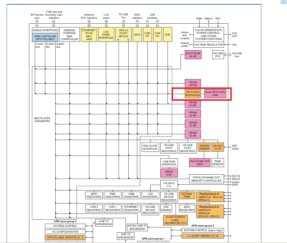

When running firmware directly from internal flash (XIP), the startup code defines the following for the image header  for "spi_clock_freq" at offset 0x1C
IF :DEF: IMG_BAUDRATE
      DCD IMG_BAUDRATE;(0x1C) image baudrate
ELSE
      DCD 0 ; (0x1C) reserved
ENDIF
However, IMG_BAUDRATE is not defined anywhere in the SDK when compiling any example in XIP.
What is the value to set IMG_BAUDRATE when running in XIP mode for best performance ?
Thank you

Actually, a good clock frequency is mainly determined by the QSPI flash chip you use.

LPC54018JxM does not have  QSPI external flash chip, it has QSPI internal flash, chosen by NXP.  What is the value to use for IMG_BAUDRATE for NXP's internal flash connected to
LPC54018JxM's QSPI for optimum performances ?

Q1) What is the value to use for IMG_BAUDRATE for NXP's internal flash connected to LPC54018JxM's QSPI for optimum performances?
-- It'd better not exceed the system clock frequency in the application code, meanwhile, close to the system clock.
