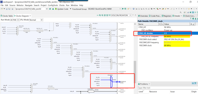

    I tried to configure 48MHz for flexcomm peripheral through clock attach clock function using kFRO_HF_to_FLEXCOMM9. But unable to do so. can yous suggest me how can i convert 98MHz clock frequency to 48MHz.

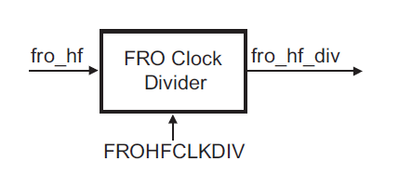

Yes. For example, When use FRO_HF, and set FRO_HF divider as 10, we get 9.6M Hz output.

We use FRO_HF divider to divide FRO96M. please see configuration as below

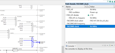

    Thanks for the useful reply. I still need a clarification is it possible to configure peripheral clock below 12MHz?.
