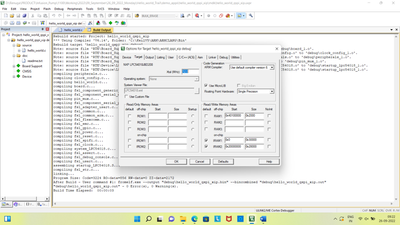

    Thanks for the training video. By following the steps taught in the video, we're able to communicate with our TFT through SPI in MCUXpresso IDE. But still, we cannot achieve the same (not getting the SPI clock signal) in keil uvision tool. How can we achieve the same in keil?.
We also tried to change the package (from 180 PINs to 208 PINs) in keil-> options for target.
Here I have attached the screenshot for your reference.

Hi @Renuga_AKAS,
I'm glad that you were able to make it work with MCUXpresso, unfortunately, I've been searching for something similar as the training and it seems there is no other documentation available that could help you port the examples into the custom board if you are utilizing the Keil environment.
I'm sorry about any inconveniences this might create.
Best regards, Julian.

    Thanks for your support. Is any other to source to utilize the keil environment for our customized LPC54018 (208 PIN) board. Actually we're able to communicate through I2C interface. Still we have issues in SPI. We're able to communicate with our TFT board (ST7789v) through SPI interface using MCUXpresso tool. If we move the same package code (even we configured 208 PIN package through "options for target") to keil uvision, we're not getting the clock signal?
Even we use the same package code in keil uvision in LPC54018 EVK board. We're not getting the clock signal in EVK board too?
Can you support us to find the solution?
