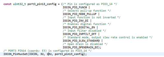

I'm trying to understand the documentation for the "lpc54018iotmodule_gpio_led_blink_xip project" that I downloaded through MCUExpresso.
Why is the pin number designated as 13 but the comments (and the actual pin number that controls the LED) say 14?
I am using the LPC54018 IoT board and the example that comes with the SDK. This snippet was captured from the pinmux.c file.
ラベル(2)
タグ(2)
1 返信
1,545件の閲覧回数
Hello ahmed_mostafa,
Yes, the default code is wrong,please update the code from "Update Code":
Then it will be right.
