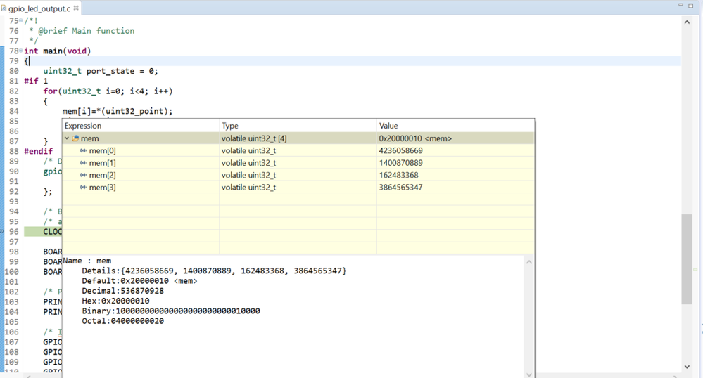

xiangjun_rong
Hi, Carl,
I have tested on the LPC54S018 board and MCUXpresso tools, and I get non-zero value for the mem[] array.
This is the result and code.
Hope it can help you
XiangJun Rong

carl-circuitwor
I've created a new project from the template, with just the code to read the ID, similar to yours. Trying both the direct read from the address in the user manual and the IAP function.
Both return all 0's
