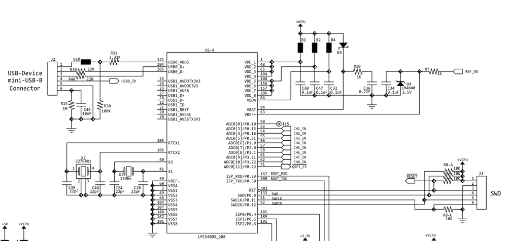

We have a custom board based on the LPC54005 MCU.
The board runs with FreeRTOS at 180M by calling BOARD_BootClockPLL180M().
We set the ADC to use the Synchronous mode with a CLKDIV of 3 to arrive at 60MHZ ADC clock.
We also set the  TSAMP to 3 and RESOL to 12Bit.
We added to symbols:
FSL_FEATURE_ADC_HAS_CTRL_RESOL=1
FSL_FEATURE_ADC_HAS_CTRL_ASYNMODE=1
FSL_FEATURE_ADC_HAS_CTRL_BYPASSCAL=1
FSL_FEATURE_ADC_HAS_CTRL_TSAMP=1
When we measure zero voltage at an ADC input we get a reading of 55 to 64 ADC units.
It seems that all ADC behave in the same manner with an offset from zero.
We use a VRef at +2.494VDC.
Is this normal and if not what am I doing wrong?

I changed my code a little of that I could use ADC0 (no temperature readings enabled) which is a Test point and I easily connected a 2.4KOhm resistor to the ground. I get an offset of about 64 ADC units for all inputs including ADC[0] with the pull down resistor. This is with the newer 2.6 SDK.
Maybe the way we connect the VREF+ is the problem. We have used this in over designs to save power when the ADC is not in use.
I added the c ADC setup snippet.

xiangjun_rong
Hi, David,
I have checked the data sheet of LPC540xx, it appears that the the data sheet does not list the VREFP pin current spec. Anyway, pls remove the voltage reference(remove R7 and U4), connect the VREFP to 3.3V, then test the ADC channel.
If there is not problem if you connect the Vrefp to 3.3V, and you do want to use 2.5V voltage reference, I suppose that you can use an analog buffer based on OP AMP for the 2.5V voltage.
Hope it can help you
Xiangjun Rong
7,740 Views
kiryat8
This morning the hardware guy tied the VREFP pin to our VCC +3.3VDC and we got the same 60 adc units when the ADC input is at ground.
thanks
7,740 Views
xiangjun_rong
Hi, David,
I have checked the code, I have not found any issue.
Your problem is that the sample is 60 if you test the GND, of course, the sample value is a bit big. Obviously, the offset is something to do with the PCB design. I want to make sure if the ADC sample is correct or not.
If you connect a waveform generator and test for example 1.67V, what is the sample? if you test 3.3V, what is the sample? If the samples corresponding to 1.67V and 3.3V voltage are correct, it is PCB design issue.
