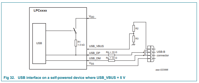

I followed the user manual to connect the USB:
and the USB works fine. i.e- PC detects a COM port when I plug the USB to the PC.

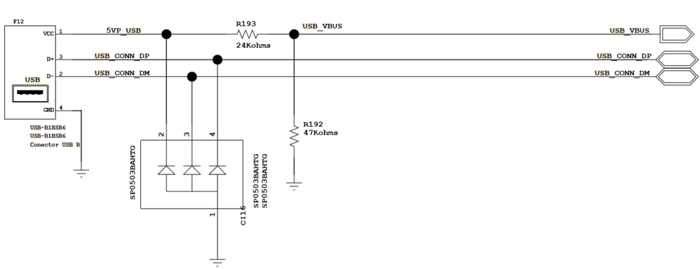

BLOCO_USB:
Filipe Costa

Hi  Filipe Costa,
The USB interface seems good, and please check the attached tool.

jeremyzhou
Hi  Filipe Costa,
for the opportunity to serve you.
I've attached a tool which is able to observe the enumeration process of a new attached USB device, please use it to validate the USB CDC device enumerate successfully.
In further, I was wondering if you can share the schematic of the USB interface of your customized board for me to check.
