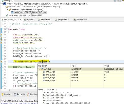

on my last project, I tried to enter the LPC51U68 in USART0 ISP Mode by invoking the function IAP_ReinvokeISP. USART 0 is routed to PIO0_0 and PIO0_1 and configured inside BOARD_InitBootPeripherals(); function.
Here below the code I add to my application, that isn't working.
I tryed the ispType 0, 1, 4, 8 wit same result, the function returns always error 10228 (0x27f4)

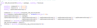

The UART0 (as I writed) is configured and activated BEFORE invoking the function. I tried further tests, and I discovered that the IAP_ReinvokeISP seems "wrong" in the project where I need to enter ISP by user code (this project is several years old)

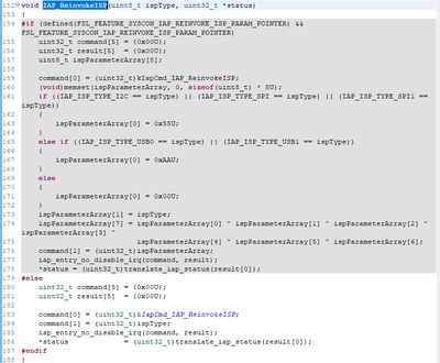

I tried in new project, and it works fine. Here below the "upgraded" IAP_ReinvokeISP that I have found in fsl_iap.c file
Using this versione It work also on this old project.

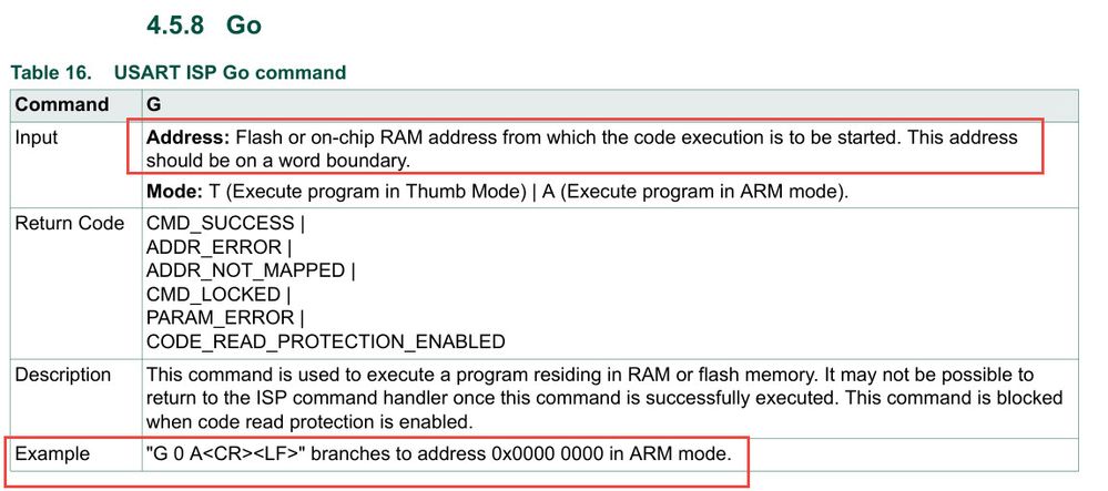

Hello @abele_barbieri
By default, the address of  reset is 0x00.
Alice
3,593 Views
abele_barbieri

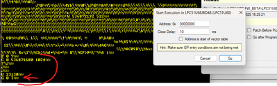

I'm sorry Alice, but if I invoke the "GO" command with address 0 the board never restart

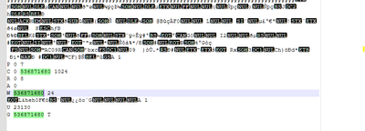

Thne, I have "sniffed" the comunication at end of Flash Magic, an here below the result
Seems the GO is on RAM address ... could you help me about?

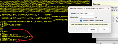

abele_barbieri
Hello Alice,
I tried to send "G" command using Flash Magic as you said ...
Here below the test I made, but the target don't restart
If I try as here, the target restarts. It seems that needs to load a code into RAM and then send G command to this area. Could you verify and send me more details about this behaviour and how I can integrate it on my code?
Abele
