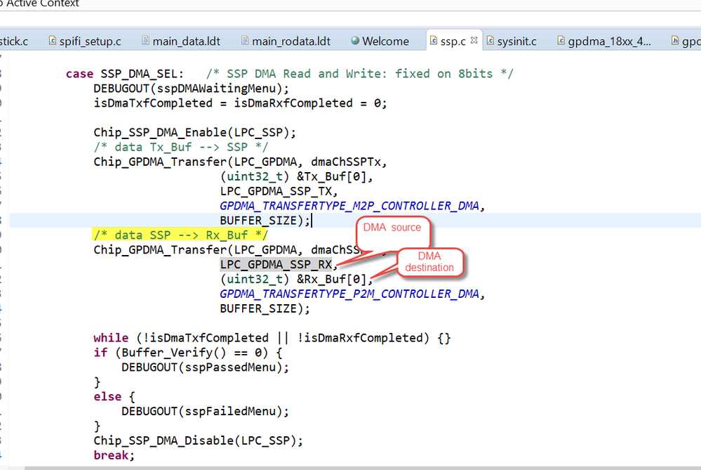

Hello John,
After ADC data ready, SSP start transfer data from ADC chip to lpc4370 DATA register,
then DMA transfer data from SSP DATA register to a buffer you define.
DMA not start immediately after ADC data ready.
You can also have a look at the demo code about DMA configuration :
TIC

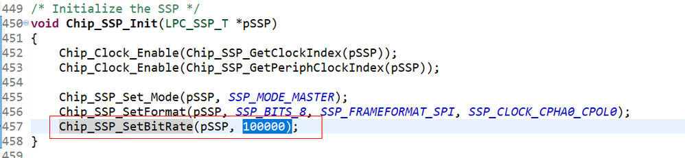

Hello John DeMar,
I'm afraid that if I understand your meaning correctly,
About "Pin Interrupt to respond to the ADC ready line to start the transfer, The interrupt is happening at 60KHz when I simply toggling a pin" - > Once the ADC data ready, there is a pin interrupt , the frequency is 60MHZ. While the DMA trigger frequency <8MHZ, right ?
If yes, you need increase the SSP clock rate ,  please check it  on your side . On the demo code " periph_ssp " ,   the bit rate is 100K.
Hope it helps,
