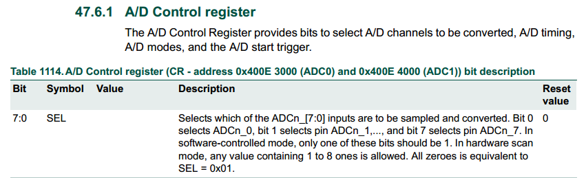

1. When a timer match signal occurs, is channel 0 sampled first, then after 11 ADC clock cycles, channel 1 is sampled, ... and so on. Can anybody confirm this?
When ADC is configured to enable hardware-triggered mode, any value containing 1 to 8 ones is allowed versus only one of these bits should be 1( Seeing Fig 1).
The result of a hard-ware triggered conversion is stored in the individual channel data registers DR0 to DR7. The global data register does not yield valid readings of a hardware-triggered conversion.
So it's a little complicate to setup DMA to transfer the data from the different source address when per ADC DMA request generates and the approach is not desirable.
Fig 1
Hope this is clear
Ping
