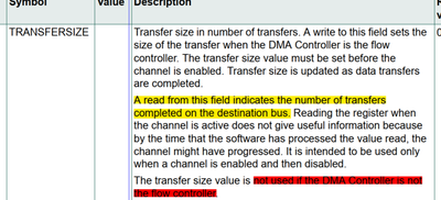

My case is ADCHS with DMA burst transfer.
  1. ADCHS
  2. DMA Flow control is peripheral  (0x6)
  3. DMA Scatter/gather.
  4. DMA Burst mode, in automatically transfer.
Questions
  1. In case of Flow-Control is peripheral, DMA Control reg b[0:11] TRANSFERSIZE (see figure) set 0 is correct ?
  2. How many size will be transfer a “DMA burst request” signal occur.
    Due to I only allocated 256 bytes for destination memory buffer.
    But the DMA keep transfers ata exceed > 256 bytes, and seems never switch to another target buffer I prepared on LLI(Link List Items) automatically.

1. Setting TRANSFERSIZE to 0:
• Since the flow control is being managed by the peripheral (in this case, ADCHS), the TRANSFERSIZE field is not used to limit the number of transfers (as indicated by the red-highlighted text in your image). Instead, the peripheral controls the number of transfers in each burst, so setting the TRANSFERSIZE to 0 is valid when the peripheral is the flow controller.

@Harry_Zhang
Thanks your clarify
Based your 3rd reply
In scatter/gather mode, the DMA switches to the next LLI (Linked List Item) once the current transfer completes
What is the exactly defination of "transfer completes" for peripheral as flow-control(HSADC) ?
In this case I set DMA control register b[14:12] = burst (0x0 << 12) . that is means  DMA burst "transfer completed" in burst on 4 bytes  = (1(SBSIZE) x  4(SWIDTH))? then DMA will lookup next LLI or raise DMA ISR for furture set/confiig? see below another post for sample code.
But as my tested, The behavior is not like as what I expect. it never raise any DMA interrupt nor stop transfer untill SRAM been full-up.
