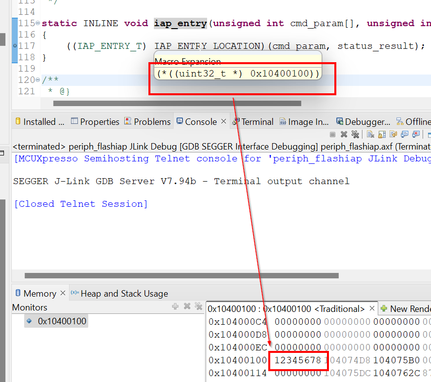

I get unexpected hardfault on default periph_flashiap project
  1. Traced the source code. I found it trapped on main->Chip_IAP_ReadPID()…->iap_entry()
    Then finally the PC counter point to 0x10400100 which mapping to ROM.(AFAIK)
    However, while dump memory 0x10400100, it get value 0x12345678??? Is it normal?
  2. I boot from SPIFI flash(0x14000000), No idea is it possible XIP in SPIFI  and erasing unused block/page simultaneously.
Chip LPC43S70.

Hello @robberpen
1) For lpc43s70 (flashless part), can not use this API to read PID.  Because on the LPC43x0 microcontrollers, the IAP API is not present.
Work-around:
Use the ISP interface to identify the part ID externally (via the UART) or read the first word
of the part ID directly from OTP memory at location 0x4004 5000. On flashless parts, the
second word of the part ID is always 0.
2) "is it possible XIP in SPIFI  and erasing unused block/page simultaneously."
->> No. When run code in external flash, do not allow erase at the same time. You can put the erase code in RAM. After erase, then XIP to run.
