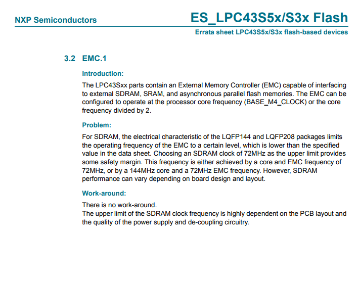

soledad
Please check the below errata. https://www.nxp.com/docs/en/errata/ES_LPC43S5X_S3X_FLASH.pdf
Sol
1,703 Views
johanborkhuis
Thanks for the answer.  We are using the LBGA256 version of the processor, so I would expect that this issue would not apply to our design. Also, the SDRAM seems to be performing fine at the higher frequency (100 MHz, main clock / 2).
