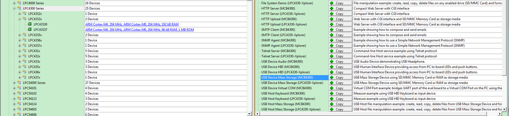

jeremyzhou
Hi julien brissard,
the opportunity to serve you.
I'd highly recommend you the USB Device Mass Storage solution which allows you to connect various drives using MSC to an USB Host: SD cards, internal or external Flash memory and even a simple RAM disk.
And you can find the demo code via the Pack Installer management.

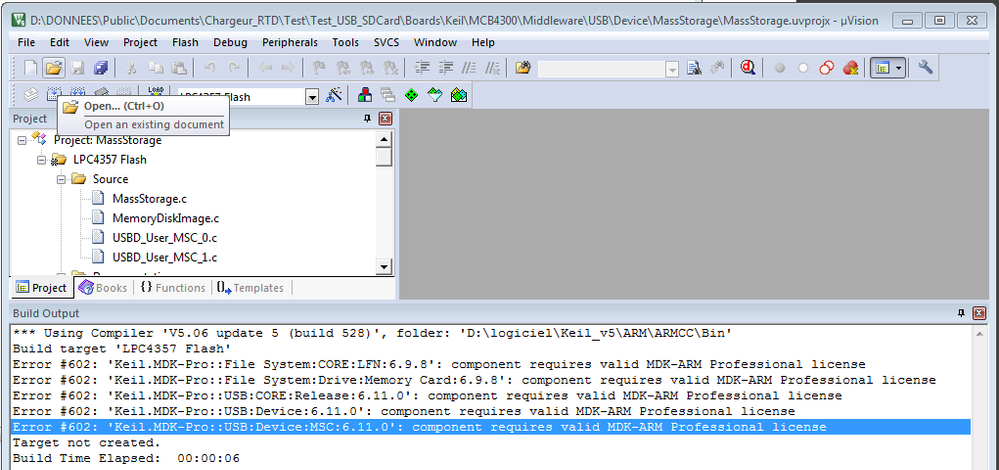

julienbrissard
Hi Jeremy,
I just download Keil environnement and the example that you mentioned.
When I build the project I get following Error :
So it seems that MDK-ARM_Pro is required for USB_Device_MSC module.

julienbrissard
Hi Jeremy,
Thank you for your support.
I am able to build the blinky project example.
So I don't think that it is a problem with KEIL IDE activation.
When I look at keil web site, it seems that USB Host part need MDK-Pro, so I understand that USB Device part is free. But they mentioned that file system part need MDK-Pro.
