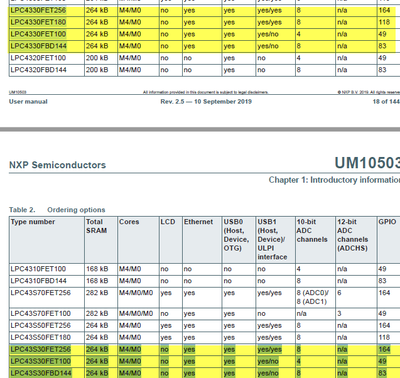

LPC43S30 pin compatibility with LPC4330
1,330 Views
stephenschwartz
It seems that LPC43S30 (secure version) is pin compatible with the LPC4330. Has anyone tried to use the LPC43S30 as a drop-in replacement for the LPC4330? (of course with all security features disabled)
Thanks!
1,318 Views
Hello stephenschwartz,
Yes, they are pin to pin compatible, you can change.
Just kindly reminder, LPC43s30 has three t
