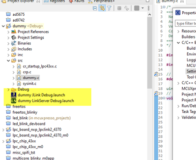

How about open a blinky demo under lpcopen for lpc4370, then directly debug it ,
using Debug button under "Quickstart":
And pay attention, before debug, delete the two .lunch files in your project:
Alice
