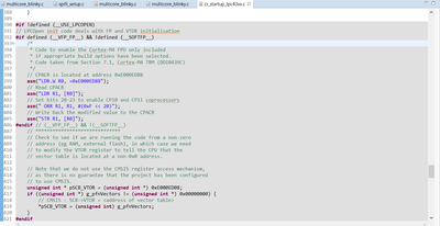

JiaAn
@frank_m
Thanks!
I found following code in my cr_startup_lpc43xx.c
#if !defined (__USE_LPCOPEN)
// LPCOpen init code deals with FP and VTOR initialisation
#if defined (__VFP_FP__) && !defined (__SOFTFP__)
* Code to enable the Cortex-M4 FPU only included
* if appropriate build options have been selected.
* Code taken from Section 7.1, Cortex-M4 TRM (DDI0439C)
// CPACR is located at address 0xE000ED88
asm("LDR.W R0, =0xE000ED88");
// Read CPACR
asm("LDR R1, [R0]");
// Set bits 20-23 to enable CP10 and CP11 coprocessors
asm(" ORR R1, R1, #(0xF << 20)");
// Write back the modified value to the CPACR
asm("STR R1, [R0]");
#endif // (__VFP_FP__) && !(__SOFTFP__)
// Check to see if we are running the code from a non-zero
// address (eg RAM, external flash), in which case we need
// to modify the VTOR register to tell the CPU that the
// vector table is located at a non-0x0 address.
// Note that we do not use the CMSIS register access mechanism,
// as there is no guarantee that the project has been configured
// to use CMSIS.
unsigned int * pSCB_VTOR = (unsigned int *) 0xE000ED08;
if ((unsigned int *) g_pfnVectors != (unsigned int *) 0x00000000) {
// CMSIS : SCB->VTOR = <address of vector table>
*pSCB_VTOR = (unsigned int) g_pfnVectors;
#endif
But I still can't understand how to enable it. Can you give me a hand, please? Thank you so much.

frank_m
Senior Contributor III
I don't have your MCU / board, so cannot reproduce it directly.
But is the following code you posted active, or grayed out ?
// Read CPACR
If it's not grayed out (i.e. white background), this code is executed and enables the FPU.

JiaAn
@frank_m  I guess it's active. Is there any way I can confirm if it's working?
5,079 Views
frank_m
The very specific code you are posted seems not active. Which might not be a problem, LPCOPEN is AFAIK a predecessor of the current MCUXpresso SDK, and supported for backward compatibility reasons. This might not be used/enabled in your application.

To be sure, you can fire up the debugger, and check the FPU init code is executed. Or check the respective flags in the core config registers afterwards.
For LPCopen / LPCware, I am no expert, though.
