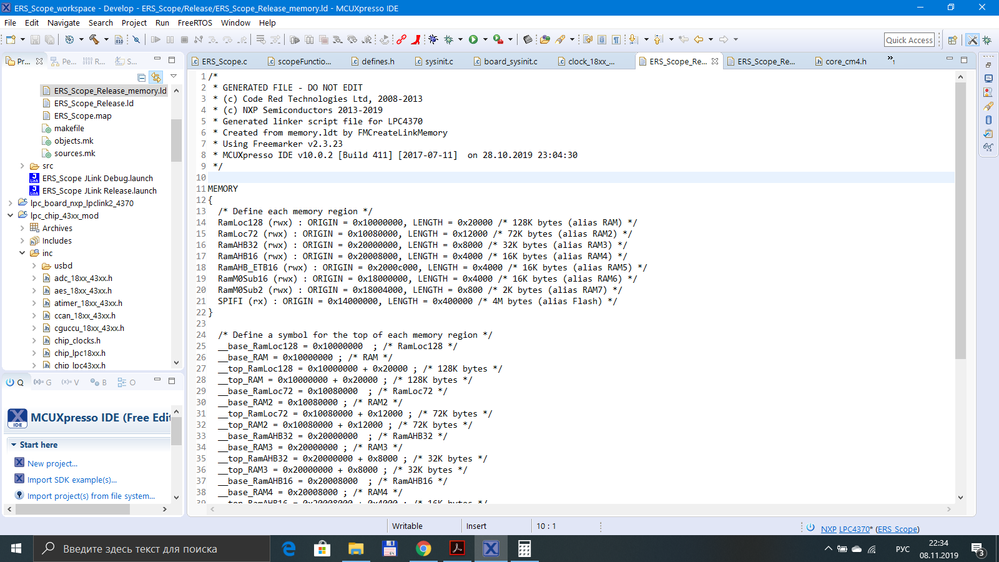

vitaliylivnov
Hi, xiangjun.rong‌
Thanks for your answer.
We have the following configuration of regions.
The code is executed from the RamLoc128 region. If I correctly understood the purpose of the MPU, it throws an exception if we try to execute code from a region that is not intended for this. We don’t have an exception; accordingly, our region has the correct configuration, right? Please correct me if I misunderstood you.
