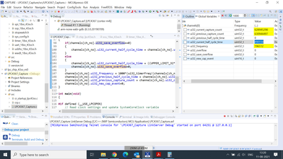

But there is one observation,  if we consider the clock freq 100Mhz , then expected difference for complete cycle is around 200 counts but the difference observed is not as per the expectation.
see the below screen shot
 It is not stable to 50Hz it is fluctuating between 49Hz to 50Hz. Here the variable "ui32_current_half_cycle_time" is just a difference between the current and previous capture value of timer 2. And as per the formula the value come around 20Mhz
channels[0].ui32_frequency = (uint32_t)(((uint64_t)ui32_timerFreq*(uint64_t)1000)/(uint64_t)channels[0].ui32_current_half_cycle_time);
Got the reason, changed the Prescaler to 0 from 1 and kept only Rising edge trigger. Now it is coming closer to the expected value.
