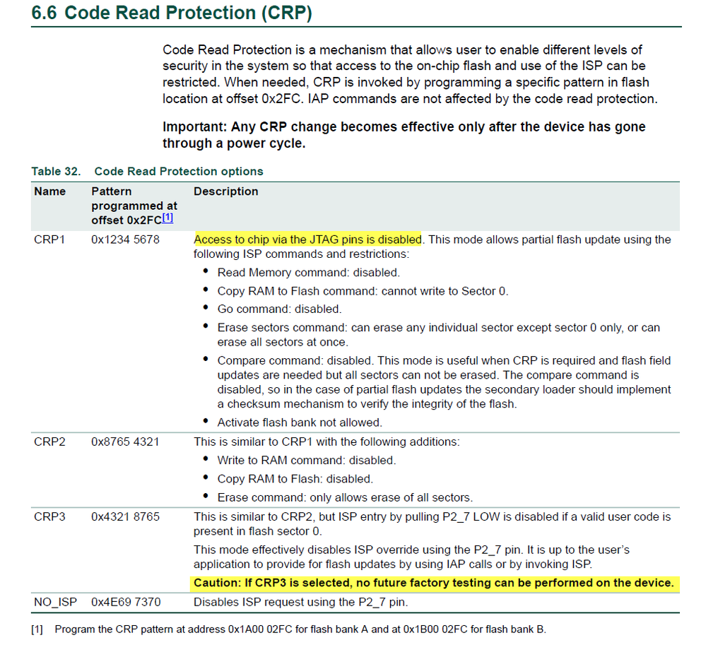

I have a number of boards with the LPC43S57 with SPIFI flash. I can program this using my Segger J-Link debugger. For a test I needed to program the internal flash, but when I tried that I got an error, and from that moment on I could not access the processor anymore using SWD (or JTAG). I tried programming the image in a second board, but there the same happened. So both boards are effectively dead now, as I cannot access them anymore and no valid application is running.
When I try to connect using J-Flash it says that it cannot connect to the target.
What could cause the processor to stop communicating over JTAG? How would it be possible to break the JTAG by just uploading an image into the internal flash? Is it possible to bring these targets back to life?

kerryzhou
Hi Johan,
    Do you operate the CPR area, it is in flash address 0x2fc.
I don't know whether use CRP3, if yes, your chip will be secured to the highest level, you can't disable it.
Now, I think you can enter UART ISP mode, then use FlashMagic to connect the board.
If you can connect the board, then erase all the flash area at first, then connect the JTAG again.
But, if you even can't connect the chip with UART ISP, I am afraid you secure the chip to highest level, that situation, you can unsecure it again.
Wish it helps you!
Kerry

johanborkhuis
Kerry,
I have been looking at that, but I checked the SREC file and could not find this value in there. But I might have overlooked something there, looking at wrong address.
It is a strange mechanism though, a special value place in your code. Out code starts directly after the vector table, so it could be that a random value was placed at this location, causing the chip to become unusable.

nxp65755
It's extremely unlikely a random value at the CRP offset matches a CRP code. I'd check to see if it's inadvertently turned on in your project settings. One possibility is your application code has muxed one of the debug pins. But, if this is the case, recovery should be a simple matter of booting the part into the ISP then erasing flash.

johanborkhuis
I did pull pin P2_7 low and now I am indeed able to connect to the processor again using my J-Link. I can read the complete flash, and saved it for later analysis. The CPR was not written (still had 0xFFFFFFFF), so it must have been some kind of init.
I erased the internal flash and programmed the SPIFI again and the unit is working again. Thanks for your help!
