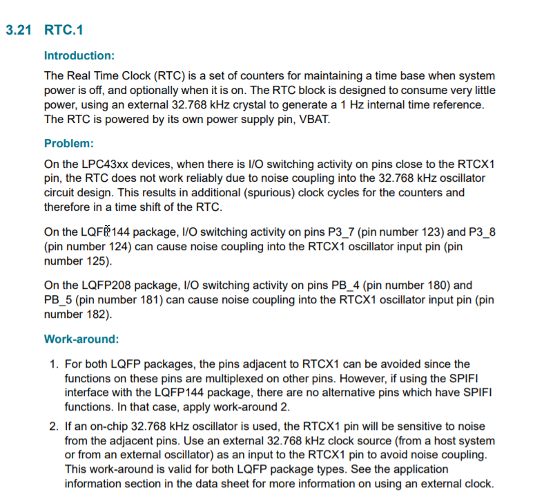

soledad
There is an RTC errata for this device, could you confirm that this issue is not related to the errata?pastedImage_1.png

ssudhir
Thanks Soledad,
However that is not our problem. It looks like RTC register retains old
configuration. Is there any status bit we need to read and find out whether
RTC is ready to be initialized?
Looked over the manual, we couldn't find any. We would like to find out why
it retains previous configuration depute of rewriting. it.
