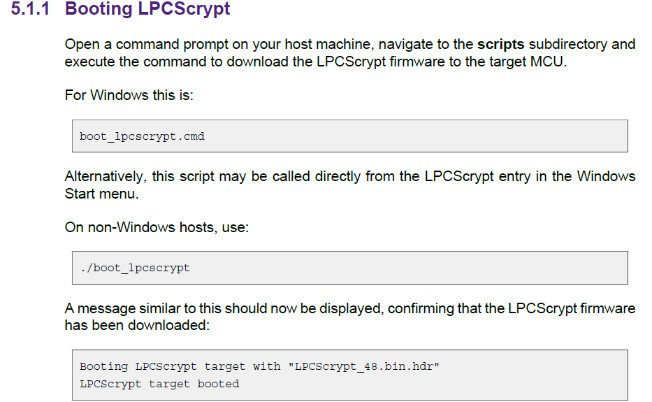

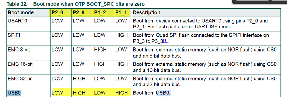

I am trying to use LPCScrypt and windows to program my application onto a custom board using the LPC4357 mcu. After setting P2_8,P2_9, P1_2 and P1_1 to select USB0 as well as setting  P2_7 LOW on reset I cannot get the virtual port to emulate on windows.
I have installed LPCScrypt_2.1.1_15.exe as well as lpc_driver_installer.exe. Am I missing something else?

Hello Heath Pritchett,
1) First please confirm config the boot pins as below:
2) We need to download LPCScrypt firmware to the target MCU:
