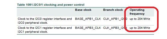

The I2C1 peripheral is clocked by CLK_APB3_I2C1. I initially had APB3_CLK, which is the  base clock of CLK_APB3_I2C1, set to take as input PLL1, which is running at 204 MHz. Therefore I2C1 was clocked at 204 MHz.
When clocked at 204 MHz, the I2C1 peripheral runs for about a minute and then starts to fail. It either will not generate any more interrupts or it will generate continuous interrupts with state=0, which indicates an I2C bus error.
If I change APB3_CLK to run from IDIVA, which is set to divide PLL1 by 2, I2C1 runs fine. I checked the errata and there's no mention of I2C1 having issues at 204 MHz. The 4358 UM (UM10503) explicitly states:
Clock to the I2C1 register interface and I2C1 peripheral clock: BASE_APB3_CLK CLK_APB3_I2C1 up to 204 MHz
Anyone know why I2C1 won't run at 204 MHz?

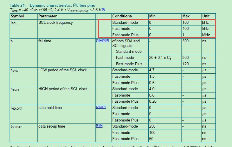

    Did you check your I2C SCL clock frequency?
  From the datasheet,
You can get that the max scl clock frequency is 1Mhz, so you should make sure when you use the clock for the I2C module, you should keep the I2C SCK clock frequency in the range defined by the datasheet.
Please check it on your side.
If you still have question, please kindly let me know!
Jingjing

I'm not talking about the I2C data rate, I'm taking about the peripheral clock used to clock the I2C peripheral. The user's manual says that it can be clocked at up to 204 MHz, which is what I initially tried. The peripheral was unstable at this clock rate, but is rock solid at 102 MHz.

    I just want to know, when you use 204Mhz clock as the clock source of I2C peripheral, what the data rate you are configuring? Whether it is exceed the highest SCK clock freqency?
  Did you test the I2C line wave when use  204Mhz?
