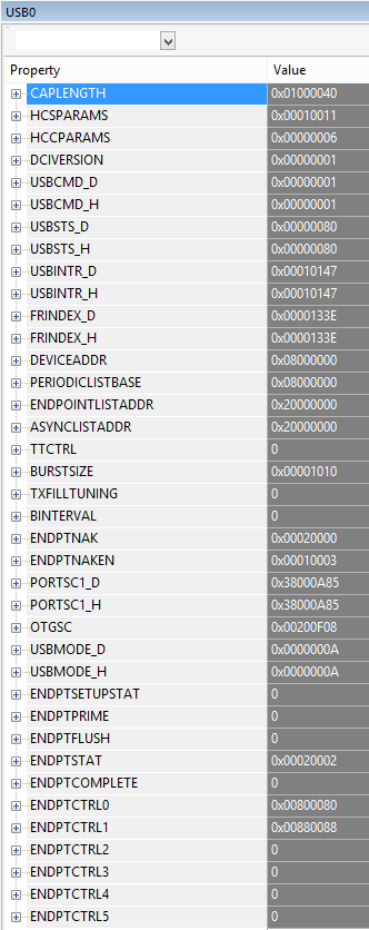

I am using libusbdev on a custom board with the LPC4357.  I am using USB0 with one Bulk IN endpoint and one Bulk OUT endpoint.  Sometimes the USB will run fine and send data continuously for several days but randomly I experience a hang.  I call libusbdev_QueueSendReq() to send a packet on the IN endpoint and it returns LPC_OK.  After this I check libusbdev_QueueSendDone() continuously until it returns 0.  (My code for these functions is shown below.)  When the hang occurs pUSB->txBuffLen is never changed from the initial packet size of 880 bytes, indicating the packet was never sent.
I have also confirmed with a USB analyzer that the last packet attempted before the hang was never sent.  The analyzer sees the normal number on NAKs after the last successful packet and then goes silent with no reported errors or further NAKs.
Because the USB ROM code is not easily accessible for debugging I am at a loss for where to look next.

USB0 Registers after the hang (in case this is useful)

Hi Dave Byman,
for the opportunity to serve you.
I was wondering if you can share the testing demo and exemplify the steps of replicating the issue.
It can help me to figure the root cause of the issue.
I'm looking forward to your reply.
