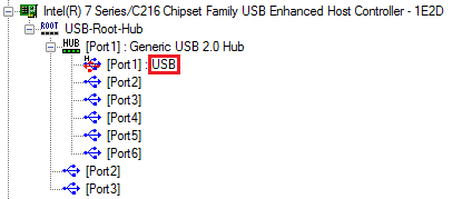

This is the configuration I'm using where the problem occurs:
The USB-Hub (Port 1) is onboard and the USB-Device (red border) is the NXP4350 controller connected like this:
I figured out connecting the device like this:
Then the problem with the missing ACKs dosn't exists
