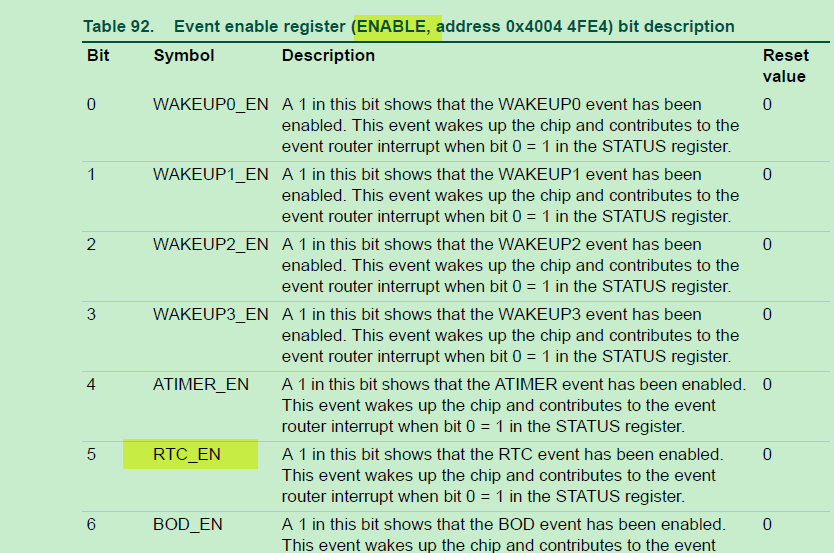

   LPC4337 support the RTC wake up the deep sleep and power down mode.
Did you enable the RTC_EN in ENABLE register? Please check it!

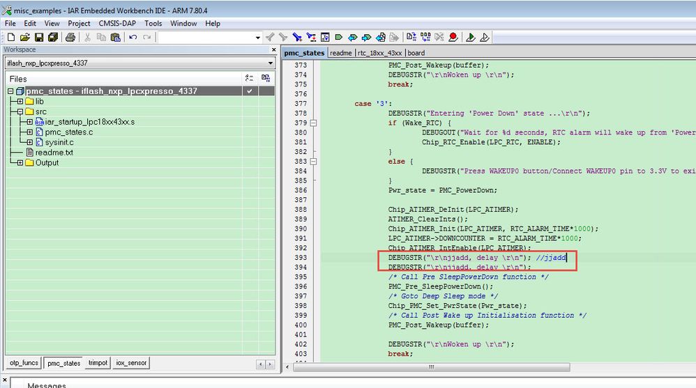

Yes the RTC_EN in ENABLED so yesterday after debugging several times the misc_pmc_states project, I found a partial solution to wake up from deep sleep and deep power down mode using the RTC.
I had to modify the misc_pmc_states project and the solution is to add a delay of more than 1 second after the RTC alarm is configured and the RTC is enabled.

      If I download the misc_pmc_states project directly to my LPCXpress lpc4337 board, and use the RTC to wakeup directly, I also meet your problem, can't wakeup. I will report this lpcopen code problem to our according department.
    But, just as you said, if I add some delay after the :Chip_ATIMER_IntEnable(LPC_ATIMER); like this:

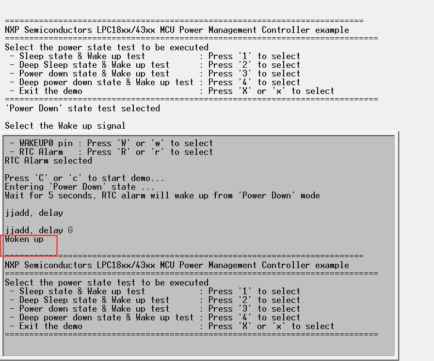

After testing, the power down can wake up, this is the test result:
The following printf is OK, it means, the clock configuration still correct.
