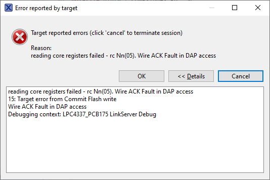

Also this might be a question for a different forum but I'm trying to use the LPC Link2 to debug and no matter what I do, I can't connect to the target (my custom PCB) to step through the program. I have never been able to get this to work but I can debug a LPC812 (both 16 pin and 20 pin) and LPC1752 with the Link2. I am using the CMSIS DAP script on my Link2.
I'll get errors like this:
NXP: LPC4337
Connected: was_reset=true. was_stopped=false
Awaiting telnet connection to port 3330 ...
GDB nonstop mode disabled (using allstop mode)
Opening flash driver LPC18x7_43x7_2x512_BootA.cfx
Sending VECTRESET to run flash driver
core registers failed - rc Nn(05). Wire ACK Fault in DAP access
Target error from Commit Flash write: Nn(05). Wire ACK Fault in DAP access
GDB stub (crt_emu_cm_redlink) terminating - GDB protocol problem: Pipe has been closed by GDB.
error closing down debug session - Nn(05). Wire ACK Fault in DAP access
I have also tried to connect to the target already running and it looks like it's ready to bug but I don't see an arrow showing where I am in the code nor can I use any Step Into, Step Over, Return from Step. Even the Resume/Resume All buttons don't do anything. I have tried this both when I know the code is running and when it's locked (I connect before it locks) but never does anything.

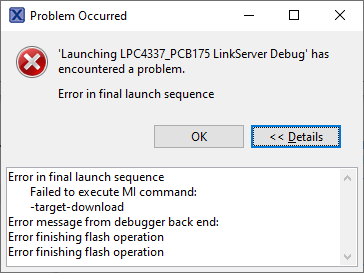

When I try to flash the target using the LPC Link2 I get the following error:
Executing flash operation 'Program' (Program file into flash: Debug\LPC4337_PCB175.axf) - Mon Sep 30 15:26:56 CDT 2019
Checking MCU info...
Scanning for targets...
Executing flash action...
MCUXpresso IDE RedlinkMulti Driver v10.2 (Jul 25 2018 11:25:37 - crt_emu_cm_redlink.exe build 555)
( 0) Reading remote configuration
Wc(03). No cache support.
( 5) Remote configuration complete
Reconnected to existing link server
Connecting to probe 1 core 0:0 (using server started externally) gave 'Ee(42). Could not connect to core.'
Server OK but no connection to probe 1 core 0:0 (after 3 attempts) - Ee(42). Could not connect to core.
Failed on connect: Ee(42). Could not connect to core.
No connection to chip's debug port
(100) Target Connection Failed
Unable to perform operation!
Command failed with exit code 1
