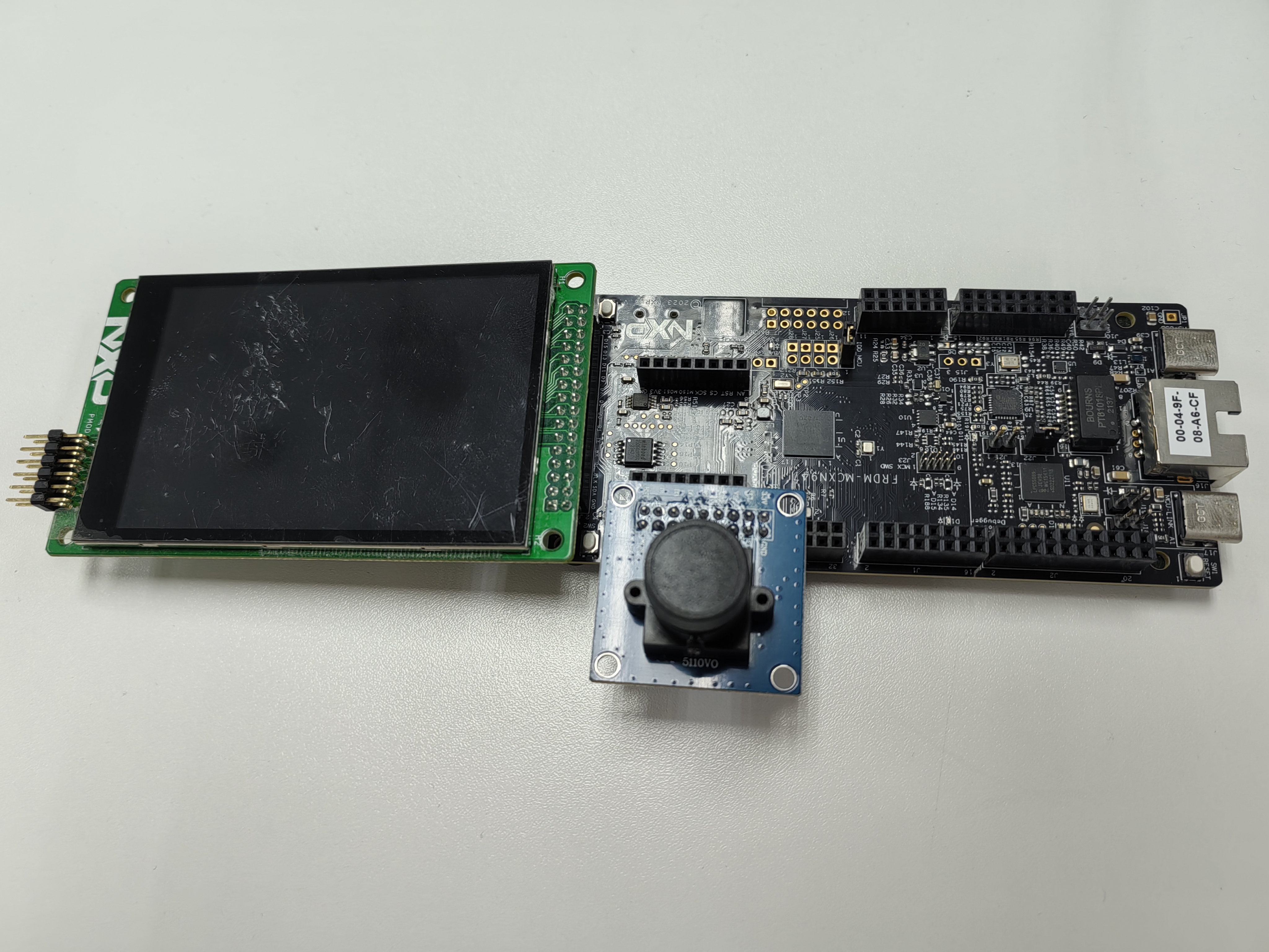

Hi, i have used a LPC4337 bosrd based in a course i did a month ago, and i am very interested in use it in a project with a 10" touchscreen LCD TFT. It is possible to connect this kind of LCD to the LPC4337?
It is possible to use any graphic tool with the LPC4337.
In case it is not possible , what  minimal and chipest microcontroller would you suggest me to use for LCD TFT 10" project?
Thanks a lot for your help.

Because the LPC4437 has LCD interface and I2C interface, it is okay to connect LCD with touch screen, but you have to check if the board has interface with LCD.
BTW, the LPC4437 is very old.
If you are interested in the LCD display, pls try the GUI Guider.
https://www.nxp.com/design/design-center/software/development-software/gui-guider:GUI-GUIDER
For example, order:
micro controller board:FRDM-MCXN947
https://www.nxp.com/design/design-center/development-boards-and-designs/general-purpose-mcus/frdm-de...
LCD:3.5” 480x320 IPS TFT LCD Module
https://www.nxp.com/design/design-center/development-boards-and-designs/general-purpose-mcus/3-5-480...
I attach the pic of connection.
Hope it can help you

Thanks a lot for your answer. I have just bought the MIMIXRT1170_EVKB  , and the 5,5" display.
Now i am redy to play with these new toys..
