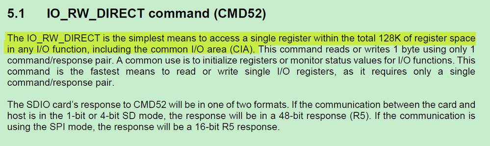

Dear All,
I am using SDIO to store data on a SD card and I would like to get the SD card size/capacity [in GB] (which corresponds to CMD9 with SD protocol and SPI). In the example ''periph_SDIO'', there is:
SDIO_Read_Direct(LPC_SDMMC, 1, 0x1C, &val) and SDIO_Read_Direct(LPC_SDMMC, 1, 0x1D, &val)
Where do the 0x1C or 0x1D come from ?

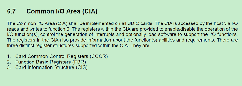

I look into the file "simplified_SDIO_card_spec.pdf" but cannot make sense of it to answer the question above. I understand that the information should be in the FBR -> CIS register (right?).
Looking further in the "periph_SDIO" example, there is SDIO_Read_Direct(LPC_SDMMC, 1, 0x04, &val) (clear the interrupt). Again, I am not able to understand or to calculate the 0x04 address.
Could you explain or point to a good document in order to understand these addresses?
Thank you very much.

Hi Valeremar,
   I checked the SDIO_Read_Direct function, it is using the CMD52 to access the according register.
From the CMD52 command description, we can get the CMD52 can access a signal register within the  total 128K of register space in any I/O function, including the common I/O area (CIA).
As you know, CIS is included in the CIA register.
So, I think the 0X1D, 0X1C, 0X04 is not the address, it should be the SDIO register.
More details, you also can refer to the SDIO card spec:
http://ugweb.cs.ualberta.ca/~c274/resources/hardware/SDcards/SD_SDIO_specsv1.pdf
https://www.sdcard.org/developers/overview/sdio/sdio_spec/Simplified_SDIO_Card_Spec.pdf
Associated with these code to find the according SDIO register which is controlled by the CMD52:
