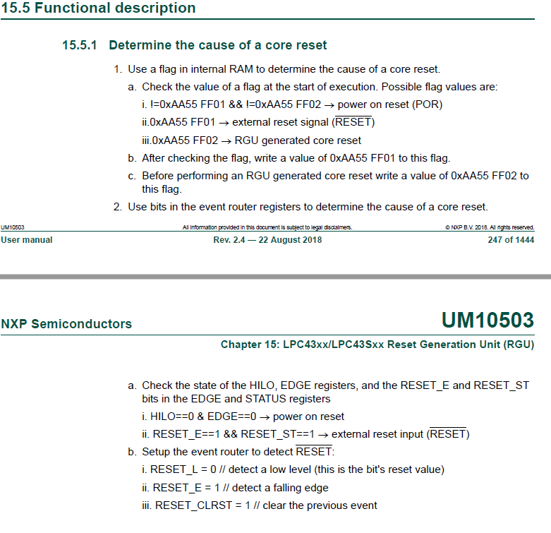

I'm interested to know the last reset causes on a product based on LPC43xx. In the user manual there are very few information about, allowing me just to know if the reset was just due to a POR, an external reset or a RGU genereated reset. It does not mention anything about a WDT reset, a BOD reset... etc.
Can anyone to give any suggestions about it?
Thank you

Hi Javier,
I suggest you use RGU mechanism with software flag to do it. It should be designed based on the customer's application. This idea comes from the below descriptions in UM:

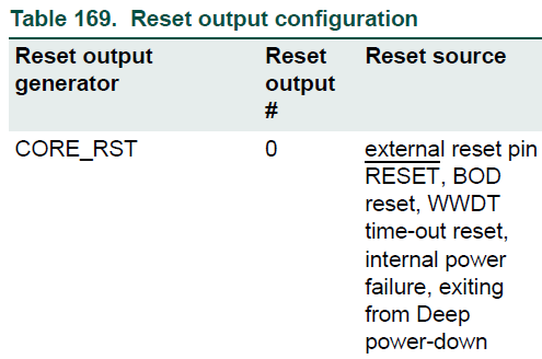

The key idea of this way is to determine the reset causes with the different values of a flag variable. It requires to determine the WDT reset by eliminating other much reset sources. See the details of all possible reset sources from UM as following:
For more information, see user manual Chapter 15 Reset Generation Unit.
