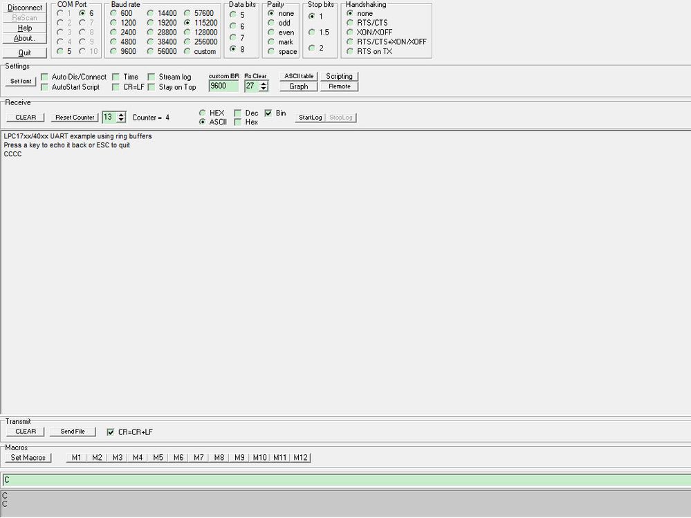

I built 2 prototype boards using the LPC 4078 and when I run the example code periph_uart_rb ( for Embedded Artists' LPC4088 Developer's Kit:)  in LPCXpresso it transmits the string "LPC17xx/40xx UART example using ring buffers \r\n"; and "Press a key to echo it back or ESC to quit\r\n"; to the PC but it won't receive anything sent from the PC.
Here is the code modified to use UART1:

I have to use UART1 instead of UART0 given in the example so I changed all references to UART1 and the transmit part works.
I am able to verify the incoming data on Pin59 P2[1] with the oscilloscope but when I look in the peripheral window UART1 -LSR - RDR shows empty. I also put a break point in the UART1 ISR but it never reaches it - the micro is not seeing the incoming data on UART1.
Both prototype boards behave the same way so it is highly unlikely Pin 59 is blown on both boards. I hope somebody could help me figure this out.

Hi ISTVAN MATE,
the opportunity to serve you.
I don't have the LPC4088 OEM Board on hand, however I have the LPC1788 OEM Board and LPC4088 is compatible with LPC1788 except that the Cortex-M core.
I use your code, but the issue is not happened and the code work well.
So I'd highly recommend you to check the value of USART1 registers in LPCXpresso IDE when debugging the code, I think it will help you figure the root cause of the issue.
TIC
2,512 Views
istvanmate
Thanks for checking it out. It narrows it down and helps me quite a bit with these crazy deadlines.
