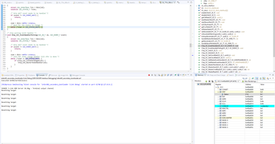

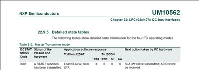

The I2C2 Status Register has a value of 0x8 which according to datasheet is start condition is sent, which is correct:
When the I2C bus is configured it is checked if the SCL and SDA is low, if yes then try to send dummy clocks on SCL to unlock it. But the code does not execute because SCL and SDA are high before and after initialization. The problem occurs when the data is sent using the API. The start condition is send when the transfer starts using Chip_I2C_MasterTransfer function:
