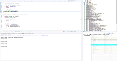

I am having an issue with I2C communication using LPC4078 when bootloaded (see Note). LPC is set as master and is communicating with a temperature sensor (TMP75CIDGK). The problem occurs in event handler:
void Chip_I2C_EventHandler(I2C_ID_T id, I2C_EVENT_T event)
	struct i2c_interface *iic = &i2c[id];
	volatile I2C_STATUS_T *stat;
	/* Only WAIT event needs to be handled */
	if (event != I2C_EVENT_WAIT) {
		return;
	stat = &iic->mXfer->status;
	/* Wait for the status to change */
	while (*stat == I2C_STATUS_BUSY) {} /*CODE STUCKS HERE*/
The I2C2 Status Register has a value of 0x8 which according to datasheet is start condition is sent, which is correct:
When the I2C bus is configured it is checked if the SCL and SDA is low, if yes then try to send dummy clocks on SCL to unlock it. But the code does not execute because SCL and SDA are high before and after initialization. The problem occurs when the data is sent using the API. The start condition is send when the transfer starts using Chip_I2C_MasterTransfer function:

As you said that the issue happens only after the application is bootloaded via I2C, in the case, I suggest you reset the I2C0 module by setting then clearing the corresponding bit in the RESTCONO register in application code, which will isolate the bootloader configuration.

thanks for your reply. I tried to reset the I2C periphery before and after pin initilialization using the library function Chip_SYSCTL_PeriphReset(SYSCTL_RESET_I2C2) but it didn't change the behaviour. The problem is that the I2C2_IRQHandler is not being called after the START condition is set/sent as described above. The I2C2_IRQHandler calls handleMasterXferState to update the registers.
When I change the event handler in Chip_I2C_SetMasterEventHandler from Chip_I2C_EventHandler (interrupt based) to Chip_I2C_EventHandlerPolling (polling based) then the communication with temperature sensor is working without any issues.
Then question is why the interrupt handler is not being called, any suggestions?
