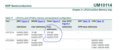

LPC2214 使用J-FLASH烧录程序的起始地址(start address)是多少?
2,974 Views
xiangjun_rong
I suppose you can set the flash start address as 0x0000, because the flash start address of LPC2214 is 0x0000.
Hope it can help you
