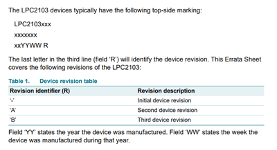

Hi I was wondering if you could explain the meaning behind the packaging marking of the LPC2103FBD48?
The one I need to identify shows this;
LPC2103F
18 02 ZSD
1829B

FBD48 means LQFP48 package
the second line is factory tracking information. not for external customer.
the third line is manufacture date and version. see below.
