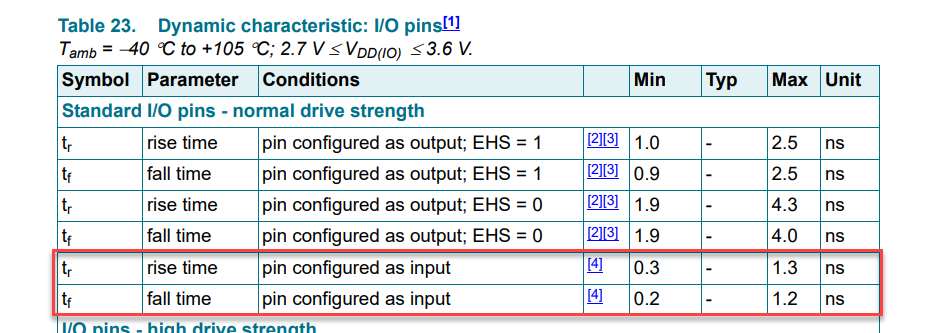

Hi tech community team,
I'd like to know the spec of wake-up pins regarding fall time and rise time.
I checked datasheet however I couldn't  find them.

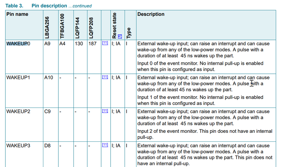

The wake-up pins are four pins, wakeup0/1/2/3.
best regards,
Yoshi
4,036 Views
Alexis_A
Dear Yoshiyuki,
This information can be found in the datasheet section 11.8 I/O pins.
I hope this helps you.
Alexis Andalon
4,036 Views
yoshiyukiokada
Dear Alexis,
Thank you for your help.
I understood that the tf/tr spec are same in both GPIOs and WAKEUP pins mode.
It would help me if you corrected my understandings.
Yoshi
4,036 Views
Alexis_A
Hi Yoshiyuki,
Yes, that's right. The electrical characteristics are the same only remember that to trigger the event the pulse needs to be at least 45ns.
