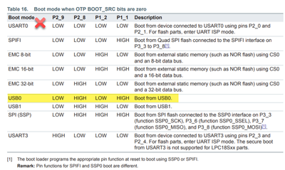

Try 1. Using LPCScrypt
As per your suggestion we connected our custom board as below
PC  ----  LPC Link2 {with JP2 connected} ---- custom board {having LPC1833,  P2_7 = low,  P2_9, P2_8, P1_2, P1_1 = low}
but the script is unable to find LPC1833. It showed Nothing to boot. Please find attached Image for same.
Please guide me how to check using LPCScrypt commands.

19,118 Views
FelipeGarcia
Hi Jigar,
Please check chapter 5 of the LPCScrypt User Guide. There is an example of how to program applications to SPIFI flash. Also you mentioned you pull all the ISP pins low. This is not correct as you will be booting from UART and you need to boot from USB0 as it is required by LPCScrypt.
Felipe
