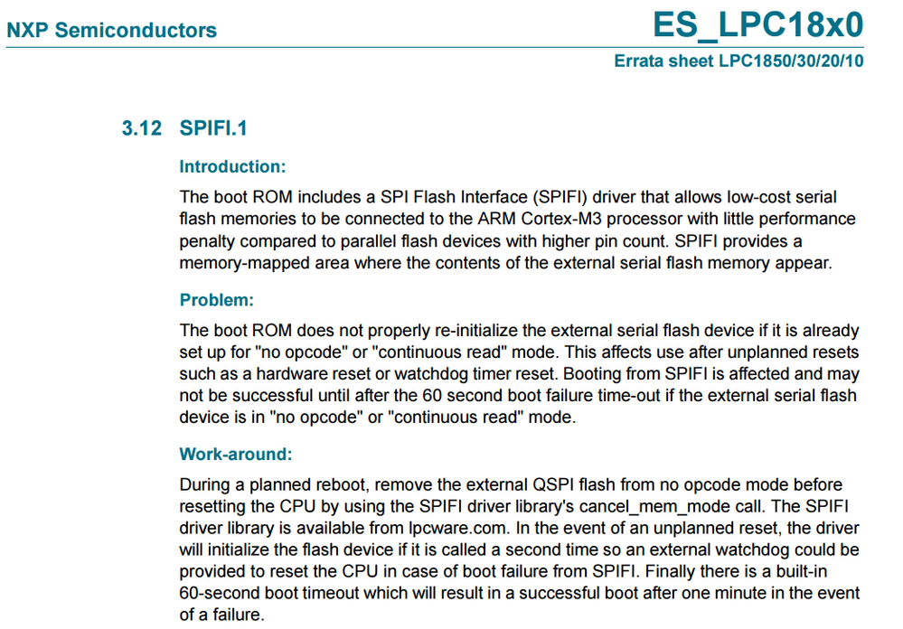

We have a boot up problem. Our project is use the LPC1820FBG100, the power source is from USB VBUS.
I take USB cable plug in and plug out repeatedly.
Our sample boards are always boot up fail. The failure rate is 5~6  / 10 time. Each board have different fail rate.
H/W setting , boot mode is SPIFI.
Our behavior is boot code copy  from external SPI Flash and execute code on internal RAM.
Is it a known issue? How can we do anything?

soledad
Please check the errata document ES_LPC18x0 regarding SPIFI (page 18).
http://www.nxp.com/documents/errata_sheet/ES_LPC18X0.pdf
Please let me know if this helps,
