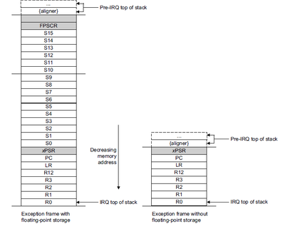

xiangjun_rong
Hi, Nico,
FYI, from your description, it appears that the stack is not destroyed,  if it is the case, you can check the stack to track the PC value which trigger the hardfault. When the hardfault happens, the 12 core registers are saved into stack, this is the Cortex-M4 register saving automatically.
Hope it can help you
Xiangjun Rong
