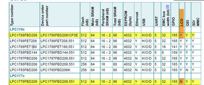

yukinobuhori
Help me. I received a request to write the source code to the target device. I received the board, schematic, and source code (hex). 1. LPC1788FBD208 is mounted on the board. 2. From which line do you write? 2-1. Signal name UART0_TX, UART0_RX USB connector--CP2102-GM (device)--LPC1788-20 2pin204pin 2-2. Signal name UART1_TX, UART1_RX Ethernet connector--LPC1788-128pin 130pin 2-3. Signal name UART2_TX, UART2_RX 5PIN connector--ADM232AARNZ (device)--LPC1788-98pin 100pin 2-4. Signal name JTAG 20PIN connector--LPC1788-20 6pin2pin4pin6pin8pin10pin 3. Source code (hex) is only one file 4. Purchase the necessary tools. teach me please. 5. Do you use Flash Magic tools or something? I have one more question. What is the difference between LPC1788FBD208 and LPC1778FBD208?

Hello yukinobuhori,
1) About your first questions, could you please describe again, sorry don't understand very well .
2) "What is the difference between LPC1788FBD208 and LPC1778FBD208?"
>>  LPC1788FBD208 includes LCD, while  LPC1778FBD208 doesn't .
Alice
