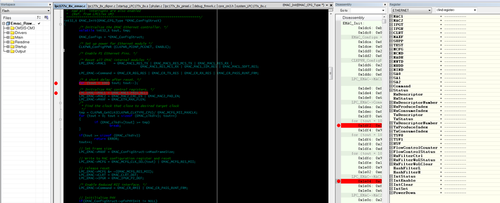

ashishg
Hello Jeremy,
Thanks for the reply.
I tried to load you project to my board via IAR Jlink SWD & use debugger to check, But same issue i am facing.
I ahve changed to IAR to LPC1778 controller.
LPC_EMAC->Command = EMAC_CR_REG_RES | EMAC_CR_TX_RES | EMAC_CR_RX_RES | EMAC_CR_PASS_RUNT_FRM;
/* A short delay after reset. */
for (tout = 100; tout; tout--);
/* Initialize MAC control registers. */
LPC_EMAC->MAC1 = EMAC_MAC1_PASS_ALL;   HANGS HERE ??????
Screenshot :

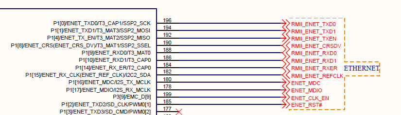

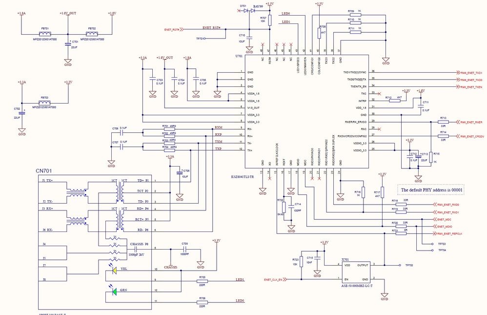

ashishg
Hello Jeremy,
I am interfacing LPC1778FBD208 with MICREL PHY KSZ8041TL over RMII only.
I also tried to run "lpcopen_2_10_keil_iar_ea_devkit_1788.zip" examples over IAR & JLINK setup to my board.
Only Ethernet example is not running (same issue) but other examples (I2C, SPI, DMA,UART) all are running .
Note : Also As soon as look into ETHERNET REGISTERS in WATCH WINDOW during J-LINK Debug mode, it also hangs as well.
Here is the schematic :

jeremyzhou
Hi ASHISH G,
Thanks for your reply.
According to the description of this issue, the weird phenomena has already happened before initializing external PHY chip which is KSZ8041TL in your design, in another word, the Ethernet module which is used to handle the MAC level fails to complete the initialization process.
It's seems like a tricky problem, so I'd like to know whether this phenomena also occur in other prototypes.
Another requirement, the screenshot is not clear, whether you share a PDF of sch.
TIC

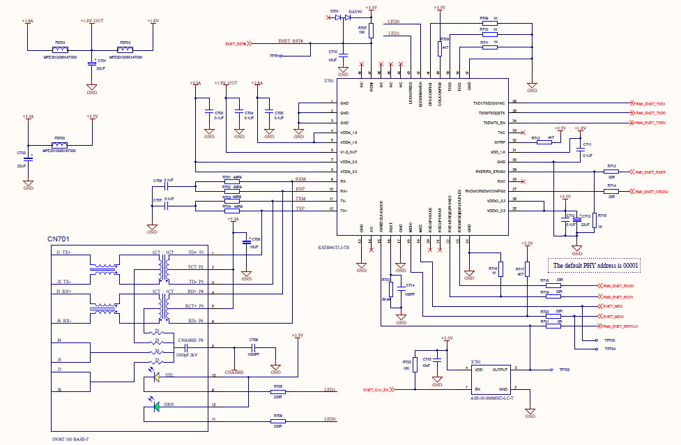

ashishg
Hello Jeremy,
I have checked in 2 prototype boards, same issue is coming. The default configuration is 100 base T for PHY
Here is the more clear screenshot
9,478 Views
jeremyzhou
Thanks for reply.
Two suggestion:
1. Confirm with the Microship for checking circuit design.
2. The reset state of pins of LPC1778 is high, as internal pull-up resistor enabled. In your design, the ISO pin is used to enable ISOLATE mode, so I suspect that the ISO pin is pull-up during power-up, please checking it.
TIC
9,478 Views

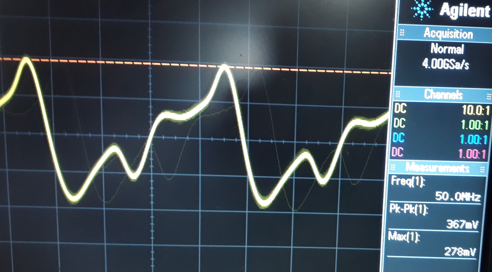

ashishg

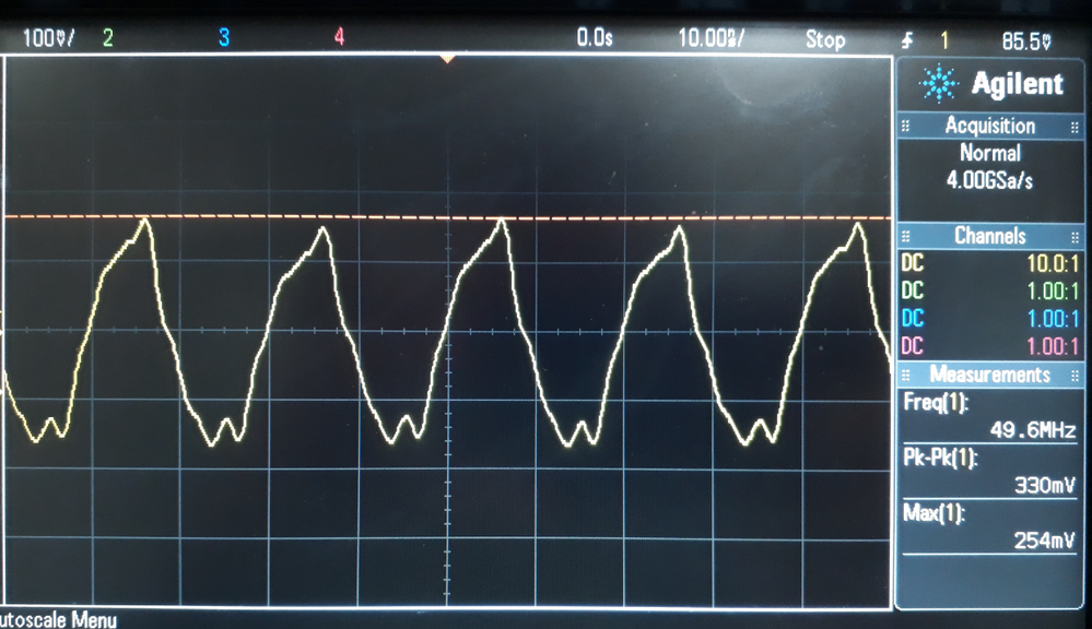

Hello Jeremy,
As looking at the REF_CLK 50MHZ the Pk-to Pk is 367 mV & Max is 278 mV.
Can you please check if this is the correct clock or i have to change something in schematic. My doubt is going to the Ref_clk issue.
Ashish Gupta
9,478 Views

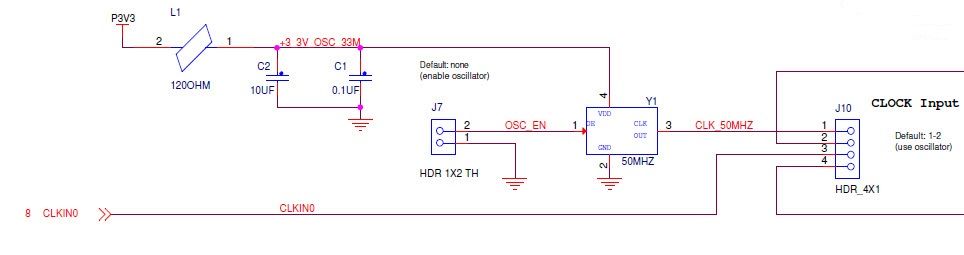

jeremyzhou
Hi ASHISH G,
To compare with this 50 MHz clock, I've attached the Fig 1 that illustrates the output of 50 MHz oscillator in Eva board, you can see the it is standard sine wave and Pk-to Pk is 800 mV, Max is 2.09 V and Min is 1.27 V, obviously, the
clock are different with yours.
So I think it maybe the cause of issue.
TIC
9,478 Views

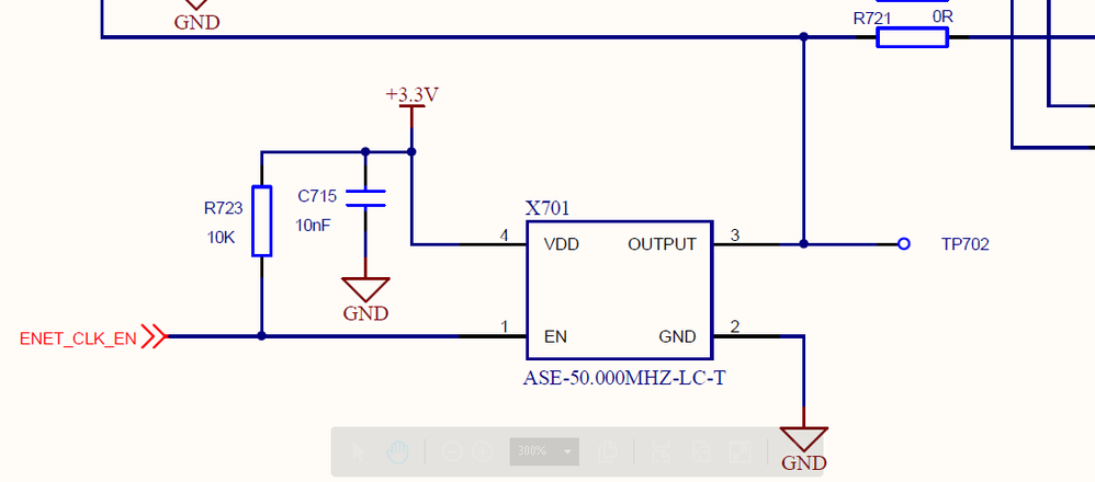

ashishg
Hello Jeremy,
I tried to make ENET_CLK_EN pin as AD_DIGITAL, these is little ok in Clock BUT the still the  Pk-to Pk is 330 mV, Max is 254mV. But issue is NOT resolved.
Are you referring to schematic of MCB1700 here for your ref clock ?
Can you suggest the part number of 50MHz crystal you are using OR Can you please suggest the reference crystal schematic for RMII for 50MHz that you have taken your 50MHz design.
Ashish Gupta

ashishg
Hello Jeremy,
The issue was with the crystal & the PCB routing connections for 50MHz crystal.
Thanks for debugging & helping me this issue. It was a great help.
Ashish Gupta
