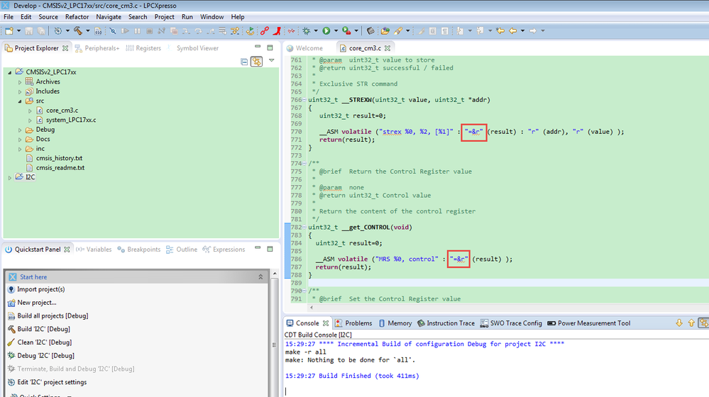

Thank you for your kind advice. I imported all the files&projects from "mcb1700.code_.bundle.lpc1769.lpcxpresso.zip" into the LPC Xpresso version 8.1.4. I tried to "build all" but an error message shows up and failed. The message says below;
c:/nxp/lpcxpresso_8.1.4_606/lpcxpresso/tools/bin/../lib/gcc/arm-none-eabi/5.2.1/../../../../arm-none-eabi/bin/ld.exe: cannot find -lCMSISv2_LPC17xx collect2.exe: error: ld returned 1 exit status
make: *** [I2C.axf] Error 1
Is any additional setting required or additional program has to be imported to build the project?
Though it might be useful just to see the sample source for initialization of I2C, I would like to see how it works  if possible.
5,725 Views
kerryzhou
Hi Hitotsu,
    Please follow these steps:
1. import CMSISv2_LPC17xx
2. modify Core_cm3.c
  Please replace all the "=r" to "=&r" in file core_cm3.c and save it, then build the CMSISv2_LPC17xx.
3. import I2C project, and build it.
You will find the problem is sloved.
Jingjing

Thanks to your information, I could successfully build the sample project after all. Although I did not yet complete the program of I2C communication, I can analyze the sample and will know how to use it!
Hitotsu
